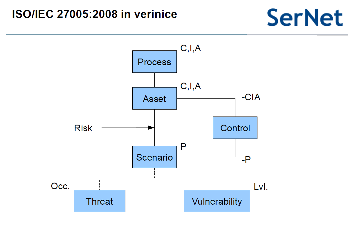

In verinice, risks should first be linked to assets.
The risk analysis process in verinice involves several steps:
Initially, the company’s processes and assets are modeled abstractly in the Model-View. These elements are then linked together, and the Business Impact can be inherited from higher-level processes down to the assets if necessary.
Next, a vulnerability and a threat are linked to a risk scenario, or a new scenario object is created.
The risk scenario must then be associated with an asset, depending on which asset the scenario poses a risk to.
Only through this link does an actual risk emerge.
The likelihood of the scenario is evaluated within the scenario object.
Once all asset and scenario evaluations are complete, the risk analysis can be performed according to ISO/IEC 27005.
The result shows that the gross risk value is calculated by adding the likelihood from the scenario and the Business Impact from the asset.
If multiple risk scenarios are linked to a single asset, the Business Impact values are summed and added to the likelihood.
The calculation formula is as follows:
Risk value = Likelihood + Impact
(Likelihood comes from the scenario object, Impact comes from the asset object.)
Controls can help reduce risks in two ways:
  • If a preventive control is linked to a risk scenario, it reduces the likelihood.
  • If a control is linked directly to an asset, it reduces the impact and acts more as an emergency measure.
The modification of likelihood or impact through the control is configured in the control object under the section called „Control-Level“.
After completing the risk analysis, the results are displayed under the respective asset.
You can also visualize these results by creating a report.
Please refer to the following illustration:
